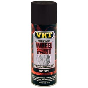

Picked up my jugs and heads today .
Looks like he gave me twobsets of 06 heads the set with the jugs have the beehive springs . The blond set has high rise springs . Spring inside a spring . I'm not shure but these heads have been worked on I figure . The heads with the jugs look like they have less km on them .
Would I just use hd rinkle paint , then sand the edgess to bring out the aluminum on the blond heads ?
Thanks F.k.
You can use VHT paint and steel wool on the fins:s

Jack has you covered on the paint.:s
