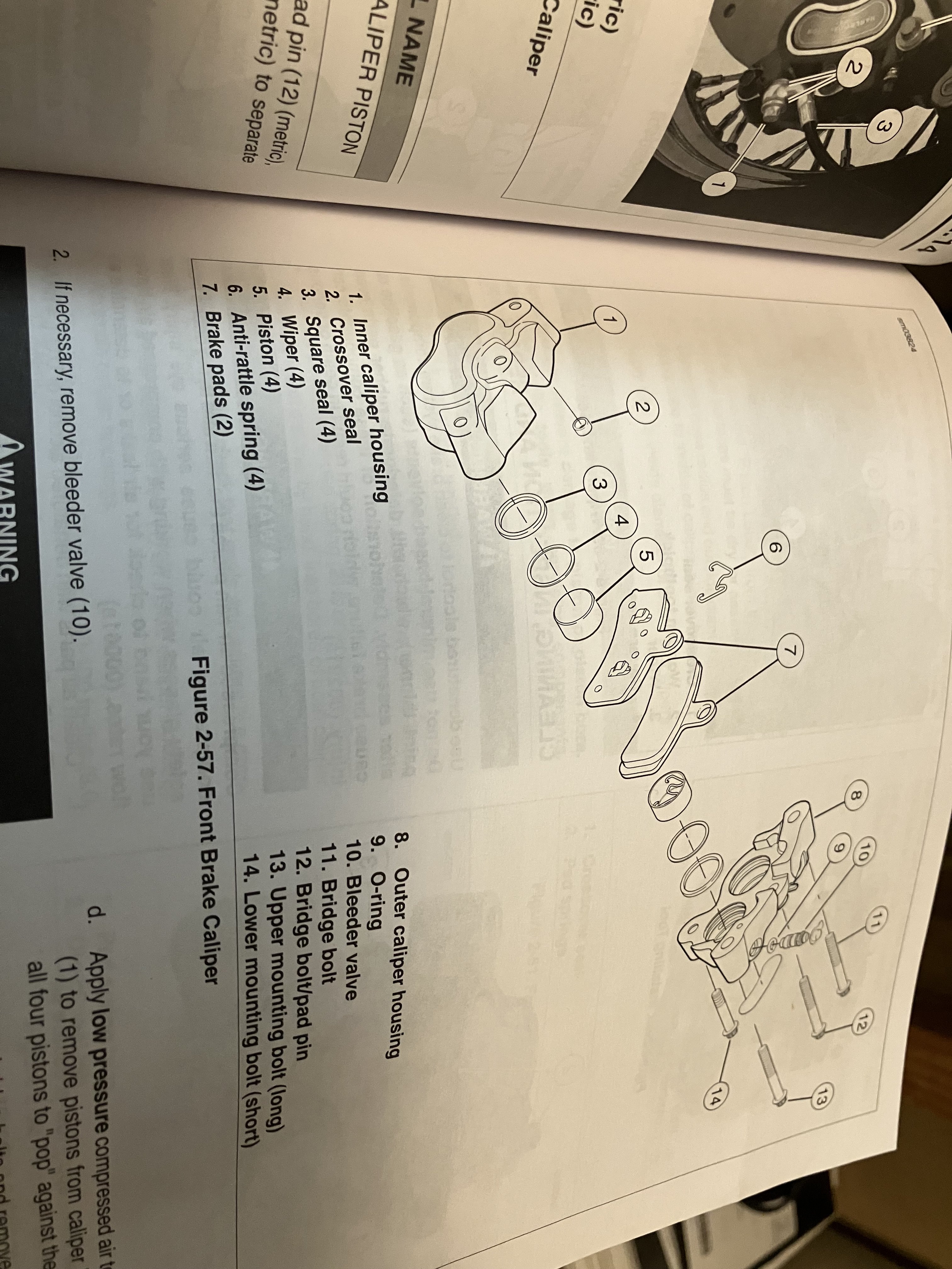

If all of your hardware is OK and lubed you may try something on the backing plates of the brake pads
See attachment, this is for a 2008 FXSTC, #6 anti-rattle spring. May be worn or missing.
