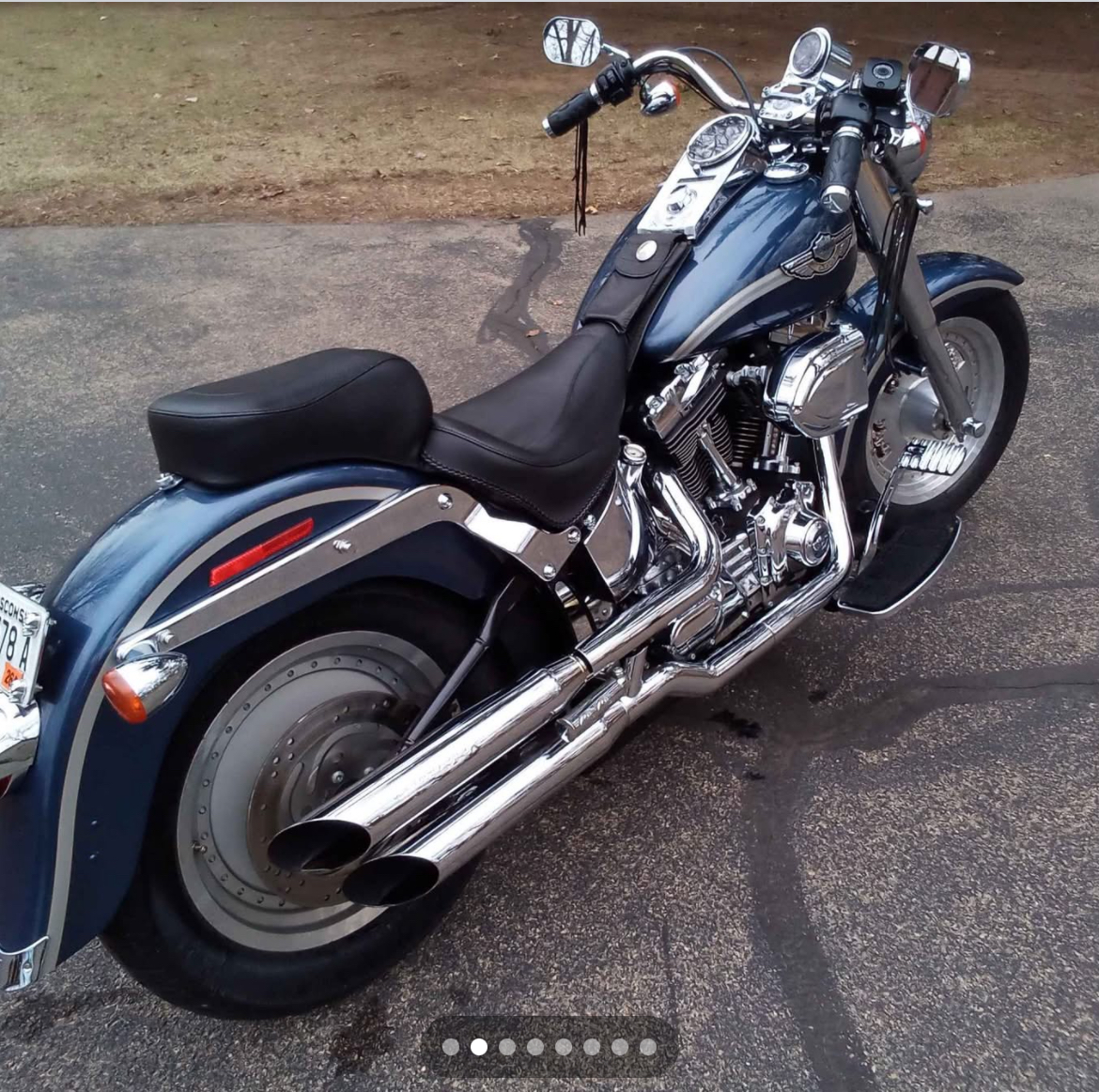

H Hifikenny New Member Jul 4, 2025 #1 Is there an oring on the primary plug? I have a drip after changing oil . Attachments IMG_5132.jpeg 1.2 MB · Views: 0
Justjake Junior Member Jul 5, 2025 #6 I read the year of your bike wrong, your 03 does not have an o ring on the drain plug, it is a tapered pipe plug that may need some thread sealant so it does not leak, be careful to not over tighten it also Check on brush on Teflon for the threads
