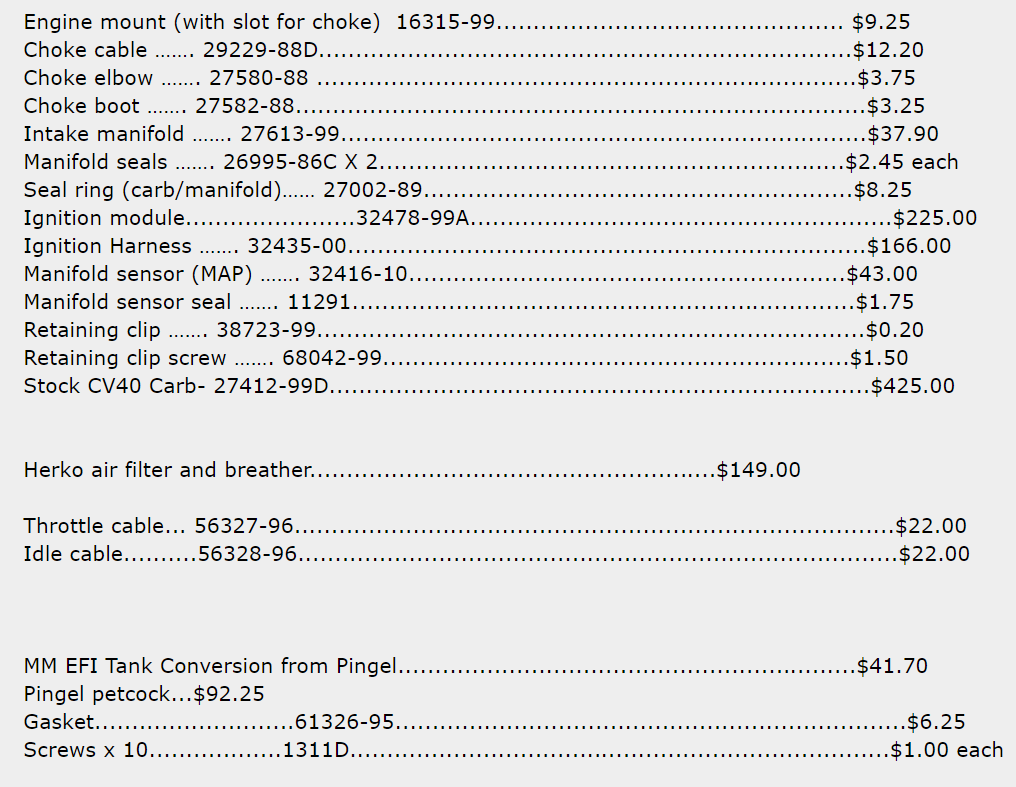

I don't know which tuner you are referring to or how much it would cost but the Dobeck for the MM system would be the best option for a Stage I upgrade but it would not support going beyond Stage 1 like more displacement, head work, higher compression, cams, etc.; just something to think about. I also don't know what is included in the S&S carb kit but if the cost is $550, I would say the "kit" is incomplete. I have never made this conversion but, from what I read on other forums, most that do convert prefer to use OEM parts for obvious reasons. I have attached a list of the parts required. The CV carb listed is a new price, you can find used CV40s on Ebay but they are getting harder to find. Mikuni 42 is also another carb used but usually at a higher cost. You would not need the air filter/breather assembly. Some of these parts may be obsolete, not sure but you can compare this with the S&S kit. JMHO but I think the cost for a carb conversion will be about the same as replacing the MM EFI with a Delphi or Thundermax setup but as you pointed out, a carb conversion might not be as efficient as EFI but with a handful of jets, needles, etc. a carb can be dialed in to perform well. Good luck with whatever you decide to do. MM_to_Carb_Parts.png

I don't know which tuner you are referring to or how much it would cost but the Dobeck for the MM system would be the best option for a Stage I upgrade but it would not support going beyond Stage 1 like more displacement, head work, higher compression, cams, etc.; just something to think about. I also don't know what is included in the S&S carb kit but if the cost is $550, I would say the "kit" is incomplete. I have never made this conversion but, from what I read on other forums, most that do convert prefer to use OEM parts for obvious reasons. I have attached a list of the parts required. The CV carb listed is a new price, you can find used CV40s on Ebay but they are getting harder to find. Mikuni 42 is also another carb used but usually at a higher cost. You would not need the air filter/breather assembly. Some of these parts may be obsolete, not sure but you can compare this with the S&S kit. JMHO but I think the cost for a carb conversion will be about the same as replacing the MM EFI with a Delphi or Thundermax setup but as you pointed out, a carb conversion might not be as efficient as EFI but with a handful of jets, needles, etc. a carb can be dialed in to perform well. Good luck with whatever you decide to do. View attachment 19825
