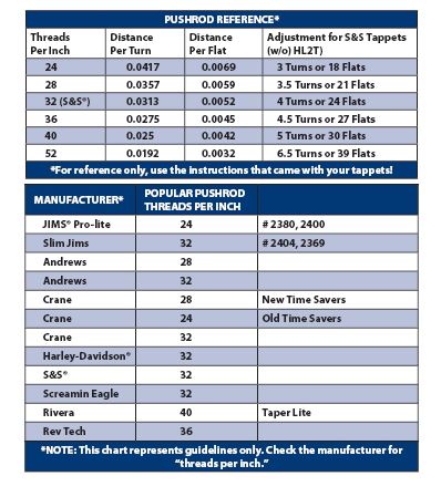

I contacted them last night and they said that they believe that they're 32 but aren't sure because they've been changed several times over the years. I'm going to try to buy a TPI gauge to be sure
I contacted them last night and they said that they believe that they're 32 but aren't sure because they've been changed several times over the years. I'm going to try to buy a TPI gauge to be sure.
Good idea; let us know how things turn out. Valve train noise is very subjective; the slightest tick can drive some to do strange things while even louder valve trains go unnoticed by others. Personally, I hate valve train noise and will go to great lengths to eliminate it. Having said that, these air cooled, pushrod/rocker arm v-twins do make some noises we just have to learn to live with. Once you get the correct TPI and readjust the valves per the previous instructions, let the motor warm up, take a short ride to get the motor up to operating temps and record and post a video.
